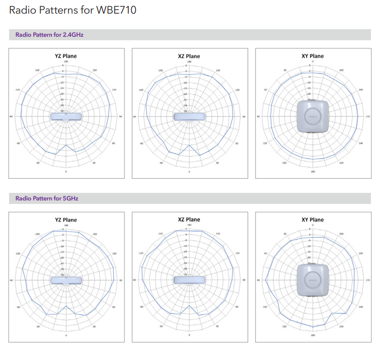

On the Pro series products, Netgear often publishes "maps" of coverage***. (something we do not see with residential products.)
Given that the WiFi coverage is roughly circular, 2000 sq. ft. corresponds to a radius of about 25 ft. 3500 sq. ft. corresponds to about 33 ft. So, the marketing literature is claiming that you will get a strong signal about 8 ft. farther away from the expensive router than from the less costly router.
Who knows? It could be that the more expensive router has a more expensive antenna.
*** Here's a random example:

HappyCat wrote:It could be that the more expensive router has a more expensive antenna.
FWIW, the power limit regulations include the antenna gain. What can vary is the number of antennas (to improve MIMO and beam forming).
- RS200: 4 antennas
- RS500: 6 antennas
- RS700: 8 antennas
Of course each antenna requires its own transmitter and receiver circuitry. So the more expensive routers have more hardware. The RS200 is also dual-band, the others are tri-band.
Not an expert on antenna design either, but 3D (generally meaning 3D-printed) antennas can be used to shape the coverage area for each antenna (which I think can be used to further improve beam forming and MIMO), but can also be used to reduce the internal space the antennas need inside the router.
