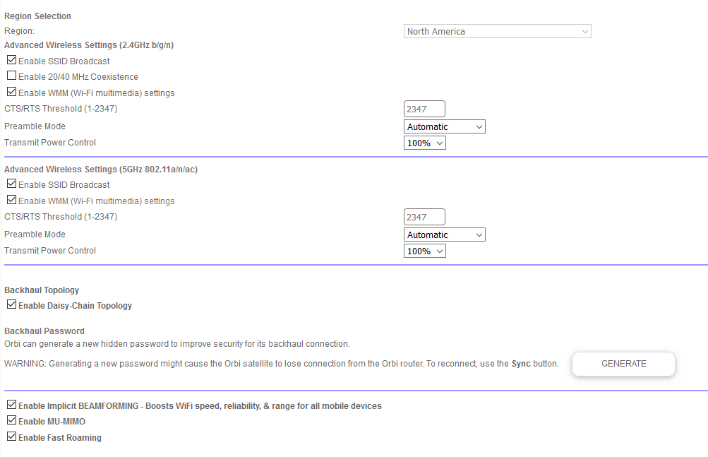

      Here are the answers to the questions that were asked:

      Channeling is set to Auto
      WiFi Neighbors, see attached photo of the spectrum of WiFi, highest is mine.
      WPA settings, WPS2-PSK [AES]
      Beamforming, Mu-MIMO, Fast roaming are enabled.WMM is enabled on both 2.4 and 5GHz
      Daisy Chain enabled - will disbale
      Fast Roaming is enabled - will disable
      IPv6 is disabled
      20/40 MHz is not checked on 2.4GHz, will not let me select 40MHz alone see photo
