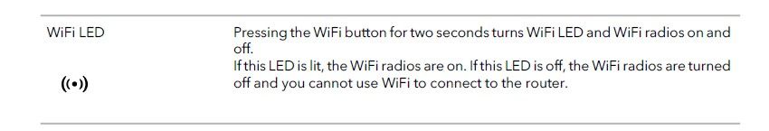

    Have you checked to see if the Wi-Fi on/off switch was accidentally pressed?  The Wi-Fi indicator LED is a combination indicator and switch.  A restart or reset does not change the status of this switch.
  • I double-checked the wifi switch by pressing it on and off and that doesn't seem to be the issue since the wifi LED is on. I've tried using an ethernet cable to connect the router to an external device and the external device isn't getting an ethernet signal either.
