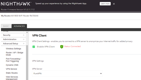

    I'm not sure what you're meaning.
    You can't log in from the router (which doesn't support purevpn) but can from a windows computer?

      Dear plemans,
      PureVPN is the only VPN Client that comes in the Firmware Version V1.0.11.112 as you can see in the screenshot below.  After checking their website I was able to solve the problem. PureVPN  provides a specific VPN Username/password you use in the router. This is different than the Windows VPN client which uses the PureVPN user account.
      The router now connects to the VPN but so far the performance is far from impressive. I have spoken with PureVPN tech support and they are looking into the problem. I will post here an update when they solve the problem.

        Wasn't aware they'd added this on the AX R6700.
        interesting. Not a whole lot of info on it so I'm not much help with that.
        What modem/gateway is the router connected to?
