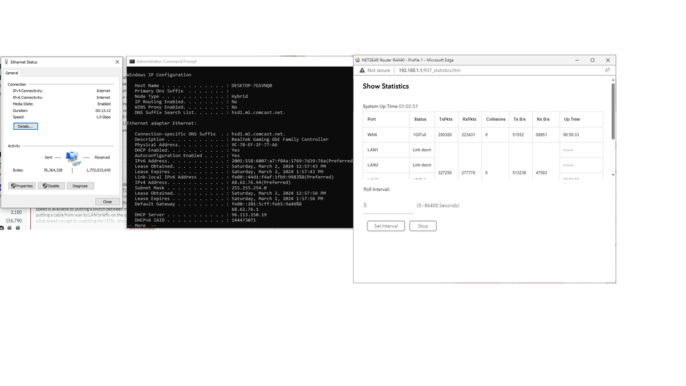

At first, I thought that there was wan port speed negotiation problem – maybe the wan port of the router was negotiating a 10Mbs speed with the cable modem’s ethernet port. But upon looking at the stats in the routers page (192.168.1.1), it shows that the wan port is set up at 1Gbs when connected to the cable modem.
Below is a pic depicting some of the configuration:
Screenshot of network ports config data
Any input would be appreciated.

By the way, the command prompt window showing the config (ipconfig /all) of the computer ethernet port when it is connected directly to the cable modem; thus, the public IP address.
