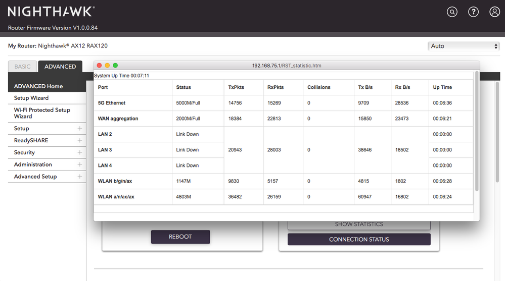

  2. Under the Advanced tab, on the Advanced Home screen, the option for Show Statistics incorrectly increments and displays values for TxPkts, RxPkts, Collisions(?), Tx B/s, and Rx B/s for LAN 2, LAN 3, and LAN 4; whereas, the values for Status and Up Time display the correct values. This is just a guess, but the values should probably be aggregated with the values for WAN aggregation and displayed there.

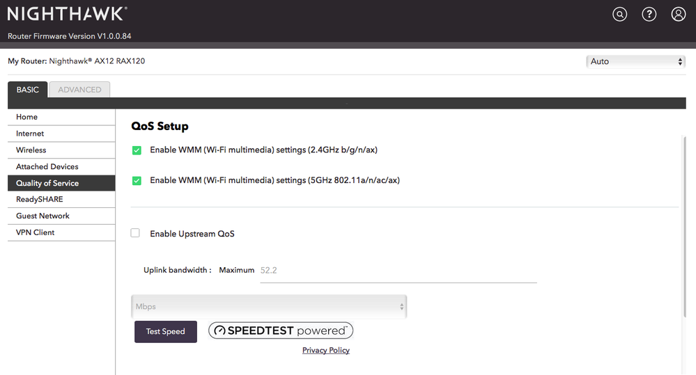

  3. Under the Basic tab, on the Quality of Service screen, only the WMM and Test Speed functionality is available/editable. The Enable Upstream QoSUplink bandwidth : Maximum, and Mbps/Kbps functionality is unavailable/not editable. He has not tested the QoS Priority Rule list (Set Up QoS Rule) functionality as is a moot point when QoS itself cannot be turned on.

    Would you verify my findings on Issue 1 and Issue 2 above? To test Issue 2 it would be best if you unplugged any cables from LAN ports 2, 3, & 4 and rebooted.
    I know you are experiencing Issue 3 as we've discussed it in a previous thread.

      I can confirm that Item #1 is the same for me, all 0's
      On Item #2, I cannot reboot at this time but will have to do that later and will write back.
