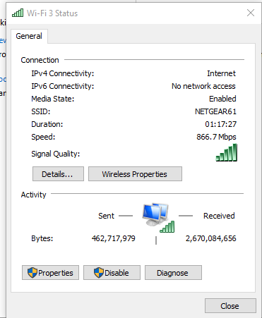

Hiya, I upgraded my internet to gigabit speed. I get that going through the ethernet cable but when i switch to wifi, I seem to be capping around 320 mbps even though I'm 20 feet away from the router with no obstructions. I'm no expert when it comes to router settings so I wouldn't even know where to begin to fix this issue. My desktop wifi says it supports up to 1.73Gbps. Can anyone help me figure out how to setup the router to send the right speeds to my desktop?

- kalyperAspirant
I ahd to look up how to check my adapter speeds and I'm directed to look at the wifi status. It says the speed is 866.7 mbps. I'm using the wifi that came built in with the motherboard, Gigabyte Z390 Aorus Master.

- plemansGuru - Experienced User
The 866mbps is link speed, not throughput speed.
Usually throughput is around 55-65% of what the link speed under optimal conditions. This can be less if there's interference, obstructions, etc.
