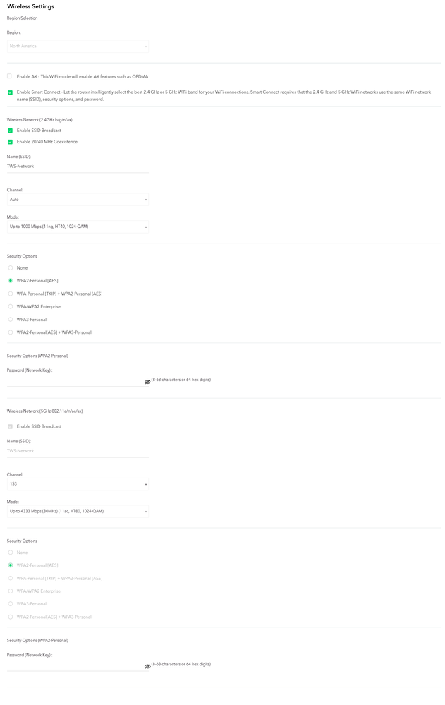

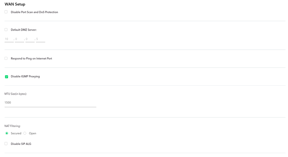

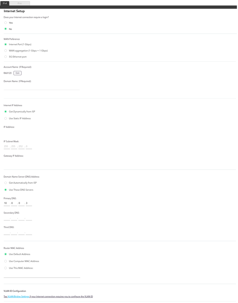

Now I purchased the RAX120 back on April 28th, 2020. Att is my ISP and due to such I had to use their hub the BGW210 to do a "IP Passthrough" to make the RAX120 act as my router. Essentially disabled wifi capabilities off of the Att hub and made the hub run as a modem. Now it still would use the base 192.168.1.254 so the RAX120 used 10.0.0.1 as the local ip. Below this will be some screenshots of my config and will have some sensitive info censored out.

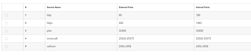

Now I have two major things used on this router. For one I have a "pihole" connected to the RAX120 that will act as my DNS. I have already tried removing the pihole off of the RAX120 all together but the issue still persists. Secondly, I have a server attached to the router that runs unraid. It does several things on it like acting as a media/gaming server. I have just a few ports open on the router and all these are set through a proxy. One thing I did find odd with my server is when I initially had it made I was able to go through all my media instantly through wifi but now it takes forever to load or even sometimes will kick me off all together. Below is a screenshot of the ports I have open...
Now I have used OFDMA mode and also tried disabling such and neither did anything. I also went through Access Control and ensured everything was unblocked. Initially I did see some of the common devices on the category "View list of allowed devices not currently connected to the network" and removed all off of that but issue still persist. Went through the logs and didnt see anything relevant there. Figured I would also check the traffic and see if anything odd was going on but everything seemed good.
