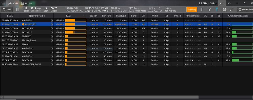

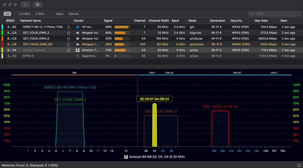

      Ive got WIFI Explorer and I’ve added a screen shot below if that helps. (I dont really understand it all)....
      My printer seems to have a stronger signal than my 2.4G network?

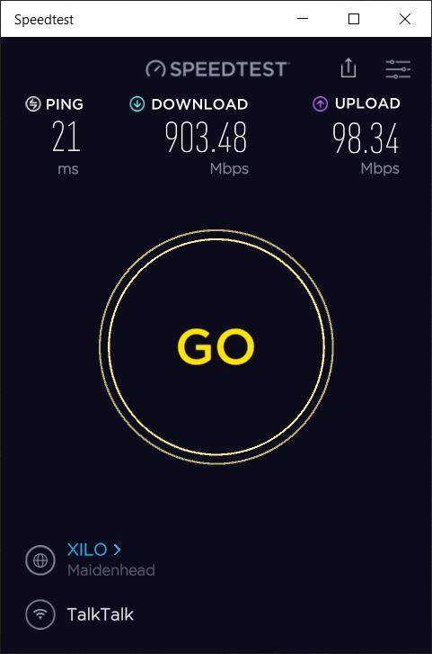

  • OP, I wonder if you've received a lemon RAX200? I'm also using a RAX200 on a TalkTalk FTTP Fibre 900 line and the RAX200 is the best router I've ever used. I'm getting 800+Mbps over wifi 6 almost anywhere in the home (new-ish double storey) and even wifi 5 clients give me around 600 Mbps. These are the settings I'm using:
    RAX200_2G: channel 6, up to 1200 Mbps
    RAX200_5G1: channel 48, up to 4800 Mbs
    RAX200_5G2: channel 157, up to 2400 Mbps
    Mu-Mimo ON
    Enable OFDMA ON (all)
    Enable Beamforming ON
    Try the above settings.
