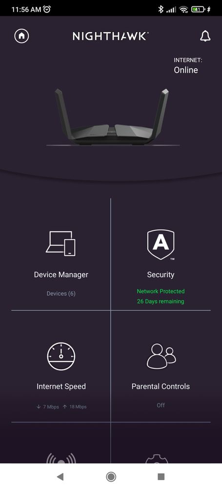

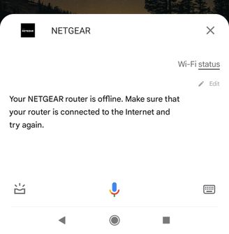

But i could not able to connect to the Google Assistant. I managed to get it linked (i think) by saying 'talk to netgear', allowed permission to netgear, sign in, bla bla. But when i ask for netgear wifi status it says router is offline. Which is funny cause i am using the router and its online. See attached screenshot.
Any idea what is wrong? Why it says router offline?

    After which when i use the google assistant to get the router status, i got the reply "Your NETGEAR router is offline".

        The 'Anywhere Access' option is enabled all the while ever since i setup the router and yet yesterday when i factory reset the router and re-setup i enabled that option again. Once done, i linked netgear to google assistant done, then i use google assistant issue the command 'talk to netgear' and then 'wifi status' or turn on guest network', yet Its the same response i got, your netgear router is offline
