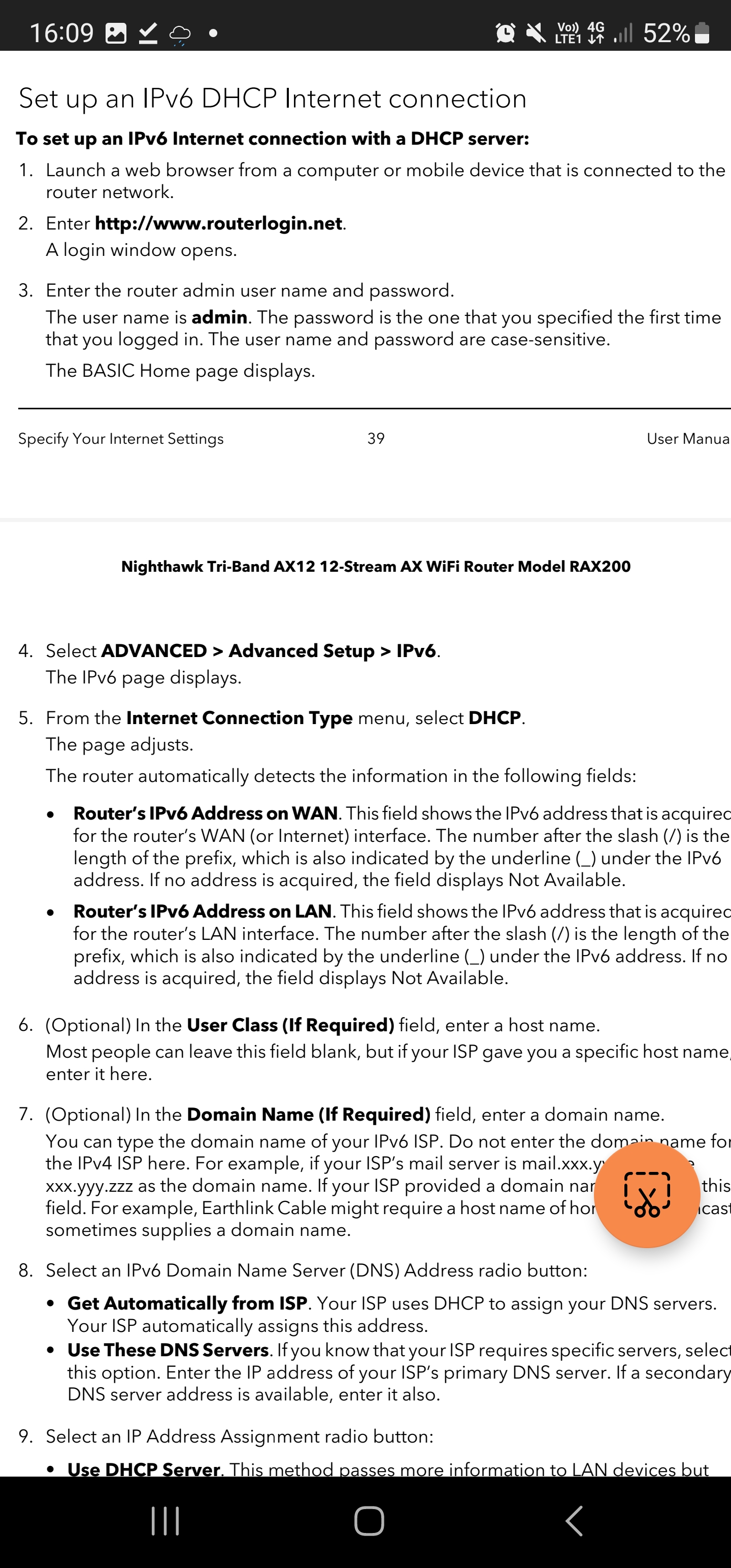

- b0redj0rdMar 19, 2023TutorHi guys, I have some good news! Thanks to all the responders in this thread, I have managed to get the RAX to connect to the Sky fibre service!
Particularly I think the suggestion to read the manual đ
Methodology as follows: Unplug existing Sky Hub for 30 minutes from the fibre box. Full factory reset of the RAX200, run through the usual set up - no Internet. Fill the connection 61 section, no Internet. Complete the section as found in the manual (attached) - connected!
