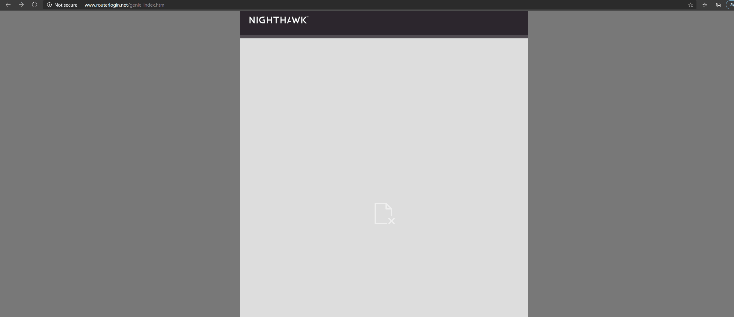

RAX35 - Bricked after installing the latest firmware
After installing the latest firmware on my RAX35 at first the wifi won't turn and then i did restart, now it won't even connect to the internet and wifi is also not turning on. I am unable to configure it using wired ethernet because it requires internet which the router it self can't connect. I have my other router that has no problem connecting to internet via my ISP's modem.

      The firmware i installed is RAX35-V1.0.3.80_1.0.1
      I did the update wired.
      I tried resetting multiple times and did not helped at all.
      The modem is a fiber modem, i am connected to it's ethernet port.
      When I go to router gui and it keeps on doing the internet check.
      Tried going to basicsetting.htm but it is not found see attached.
