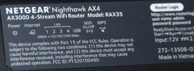

Hello, I just purchased a Netgear Nighthawk AX4 AX3000 4 stream router. On the bottom sticker Model: RAX35
When I log into the web interface the model displayed is RAX35V2

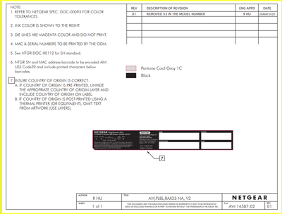

I searched google for RAX35V2 and found next to nothing. The only interesting link was to a FCC filing from Netgear which modifies the bottom sticker to remove the V2 from the model. Any idea why they did that?
Since Netgear has no mention of the router on their website maybe they were expecting the router to be released later this year??

    In terms of the v2, it could have been a hardware change during testing. I've been involved in betas that had to have changes done to the hardware due to issues found during the beta. Technically the released is a V2 but its considered V1 since it wasn't the released product. Maybe that's what you're seeing?

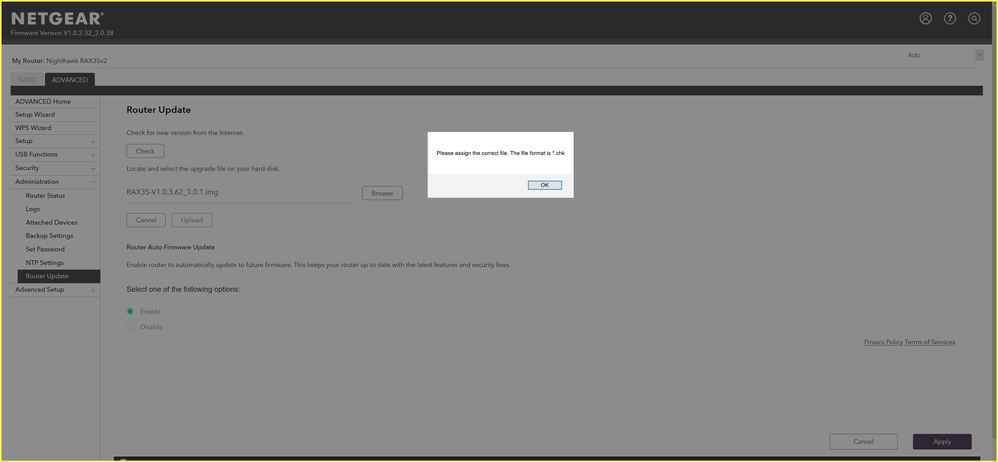

      Thanks for your quick response! Well the reason for all this is because I was trying to upgrade the firmware. I wanted to upgrade firmware and configure the router before I hooked it up to the internet. So I downloaded firmware for RAX35 since that's what the sticker says and tried upgrading firmware.
      The RAX35 zip file contains RAX35-V1.0.3.80_1.0.1.img  and RAX35-V1.0.3.80_1.0.1_Release_Notes.html
      From the administrator menu I select Router Update, then select the .img file and hit upload and receive the following error:
      Please assign the correct file. The file format is *.chk
      Seems weird if they completely switched firmware formats from .img files to .chk files in between one model, right? I dunno.
      I didn't see the v2 in the upper left until after attempting the upgrade. So I considered myself lucky I didn't brick anything, heh.
      also in the upper left:
      Firmware Version V1.0.2.32_2.0.38
                                                     ^ I'm guessing this denotes V2?
