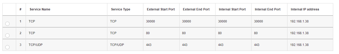

        When I connect on the LAN I have to type in 192.168.1.38:30000 because I believe that the Pi is listening at that port.  If I type any other port (or no port) then it won't work even on LAN (nginx reverse proxy throws up a 404).
        >Did you configure port forwarding on the router...
        I configured Port Forwarding on the router.  But I could have done it wrong.  Screen shot attached.
