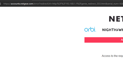

Same thing here with rax50v2. Tried multiple browsers, multiple devices.
firmware v1.1.4.28
I chatted with support. They said that log fills up and causes issue. I had to reset the device to factory.. ug. That fixed it.
This time, I will save a backup configuration file so I can put back all the settings like wifi, dns, port fowarding.

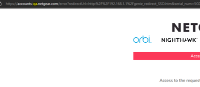

I am not OP just to be clear.
I noted that the redirect url has "qa" in it: https://accounts-qa.netgear.com/error?redirectUrl=http:%2F%2F192.168.1.1%2Fgenie_redirect_SSO.htm&serial_num=xxxxxxx
Took out "qa" and it is same result. Cable box is owned Surfboard s33 to Xfinity.
NETGEAR should enable clearing the cache from the mobile app. I am able to access the router via the mobile app, but not via the web interface. I'm so pissed about not having access to it and thinking that I don't have a backup of all the configuration. I can't believe this is happening in 2024 where a seemingly good router would block my own access because the log cache is full. Unbelievable.
