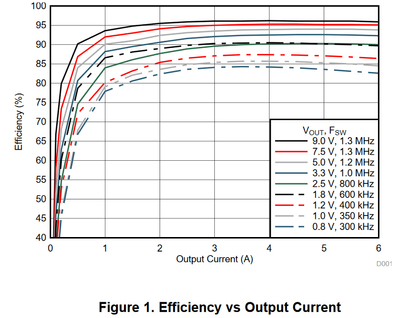

        Basically for power consumption at the wall vs power consumption of active components, thereis nonlinearity in overall power draw of the individual components vs what you will see at the wall. Every voltage regulator has a an efficiency curve for its regulator as all components get closer to their peak efficiency curves, you will see the delta between thewall current draw and the sum total of the component level current draws shrink, and as they move away from the peak efficiency points the delta will increase. As the activity level of an active component changes, the area of the efficiency curve that its power draw corresponds to will change as well.  Here is a random example that you will see with many typical DC to DC regulators. Nothing is 100% efficient, and the delta between the efficiency at a given load and 100% represents how much of that energy is being wasted and effectively added to the the actual load on that power rail.
        The overall point is that if the user needs to determine the total electrical usage, then it really has to be done at the outlet level. For example, using a kill a watt tool to measure the wattage that it uses over the course of a week, and then calculating an average based on that, which will allow a user to know the effective cost of running the device. Beyond that, due to how variable the power usage can be it would be hard for any company to provide much energy usage data. since it all depends on how the user uses the device.
