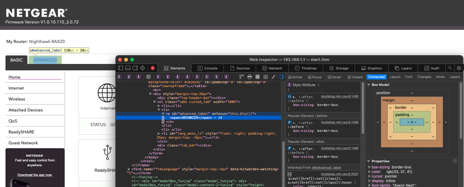

Updated today (2022-03-24) to Firmware Version V1.0.10.110_2.0.72 and now I cannot access the Advanced tab on the router setting page. I looked at the HTML source code to see if you could just grab the link and enter it into the address bar on my browser but there was no link.
<a id="advanced_label" ontocus="this.blur()"><span>ADVANCED</span> = $0</a>
See attached screen cap for more details.
Not sure if there is a way to get the link and just bookmark it or if there is quick fix for this issue. Any help would be appreciated.

What browser are you using? Happens with other browser?
Be sure to clear out all browser caches.
Try a factory reset and setup from scratch and see.
- rbk-rax20Initiate
Was using Safari, tested in FireFox and that was the fix. FFS Apple is killing me these days.
