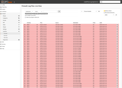

Apart from the annoying ICMP attempts to Google DNS servers (which I believe is a bad practice to check if we are on-line), I can see my router is trying to connect to various servers at TCP port 8883.

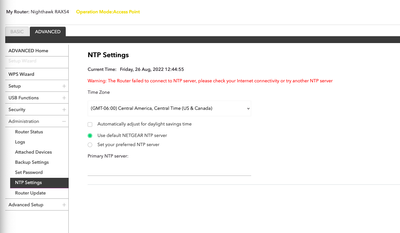

At the same time, I can see an error message in NTP Settings.
Could that "default NETGEAR NTP server" be what the router is trying to connect to, at a non standard port? Standard NTP would be UDP 123 and UDP port 123 is open on my firewall, why would the NETGEAR NTP server be not accessible?
If there is no correlation between the two, I still would like to know what my router is connecting to at TCP 8883, and why the NETGEAR NTP server is not accessible.

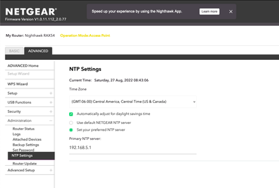

All those features disabled because of selecting AP mode I expected. I would want my firewall do most of that, and it does.
However, after changing the NTP settings to my own NTP server (the firewall), the router stopped trying to connect to those addresses at TCP port 8883.
So it seems, that "default NETGEAR NTP server" is not a standard NTP server, but some NETGEAR proprietary solution to sync time.
