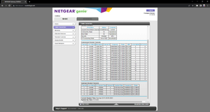

At the subject says, I see reports of DoS Flood Attacks in the logs to the internal port IP address. Now I don't have any issues with connection or anything except for when it comes to me attempting ...

Posting an image of a portion of the logs as well for reference if needed.

NETGEAR's DoS protection is highly flawed and known to block and generate many false positives, even from your own local network and devices. If you look up IPs from the logs, many will be legitimate ones coming from MS, Apple, Amazon, etc for example.
Disabling DoS protection might solve your issue. Trust me, after years of experience of running without DoS protection on various NETGEAR routers, you're not missing much. If you keep DoS protection on, most of the times you'll get a false sense of security or "protection" as only a percent or two are legitimate.
Sound advice. Here's a tool that makes it easy to conform that those logs show events that are, in the words of the HHGTTG mostly harmless.
