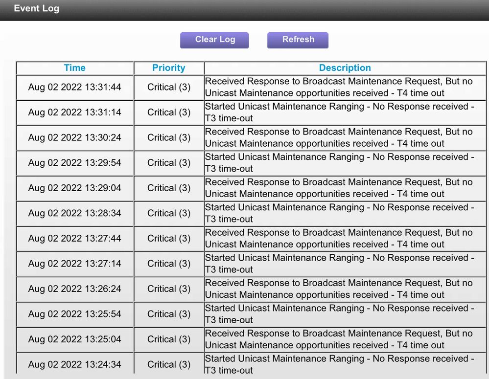

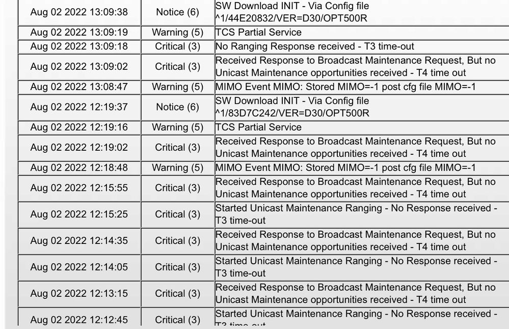

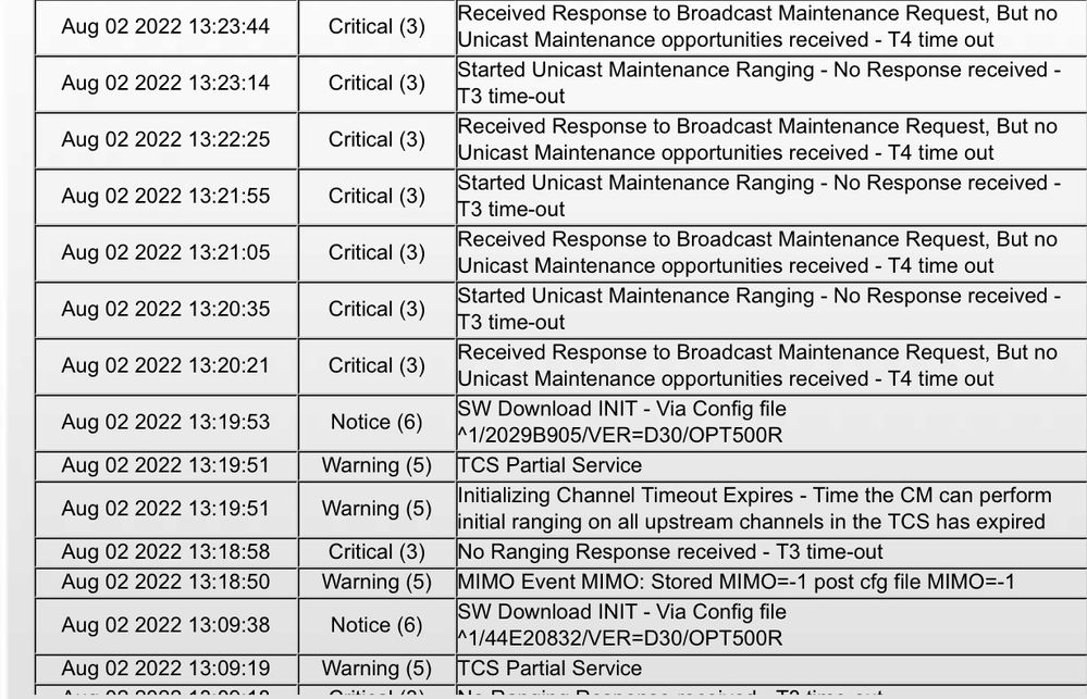

Post the Events Log page as well.
- Inernot44Aug 02, 2022Aspirant
Thanks for getting back so quickly. Is low power a reason for the internet led to be dark? I’ve spoken to Optimum (ISP) and they are terrible and only recommend me using their routers. Which I despise because of fees but also because they are often outdated.
Here is the Event log as requested:
- FURRYe38Aug 02, 2022Guru - Experienced User
Yes and you have a bunch of criticals as well. Something the ISP needs to help resolve.
