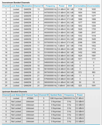

Just yesterday my router (hardware version C7000v2) started having connection issues. The internet works for 10-15 minutes and then shuts off for 10-15 minutes, and constantly repeats this process. Looking at the router lights, I see the upstream light is the amber color. I don't know what this stuff means but I see others posting for this issue.
1) How do I go about fixing this and what could have caused this to spontaneously start happening?
2) What are correctables and uncorrectables? Do I need to be worried about these?
3) If I have an ISP check my connections, do they need to come out, or can they do that remote?

Your upstream power levels is super high. Usually if the downstream is high, the upstream will be low. It tends to indicated you're close to a hub (if the downstream is higher) so it doesn't take as much power and the upstream will be on the lower end. With where your upstream is, I'd expect your downstream to be pretty low. But its not. Its at the higher end too. So its either indicating you're using an amplifier (get rid of it) or something else is impeding the signal.
so check your line, remove any amplifiers.
- mdecker2Aspirant
It turns out there was an issue with the whole neighborhood, not just me. The issue was resolved late last night by our ISP. Thanks for all the info tho this was helpful.
