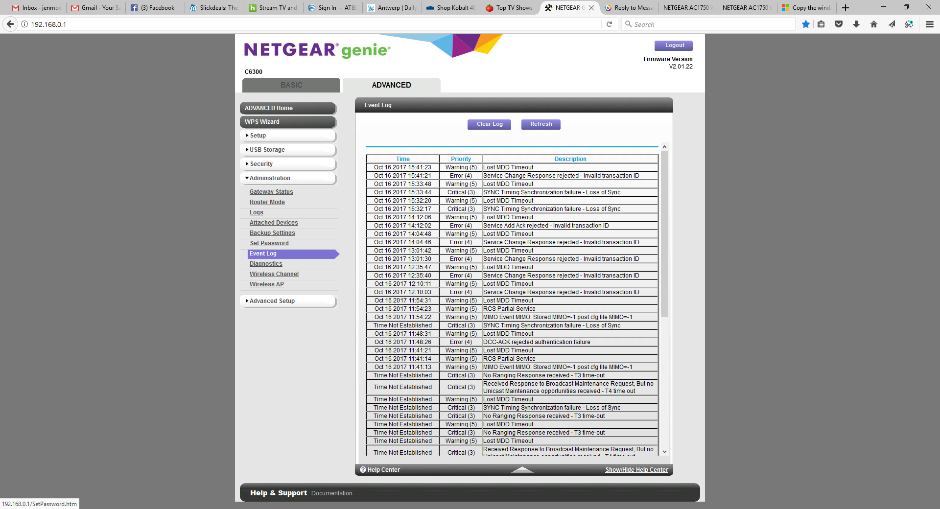

- Wileycat221Oct 16, 2017Aspirant
Hi--
I'm having the same problem with the amber upstream light. I'd be obliged if you could take a look at my screen shots and advise.
Jen
Here's the event log to go with my question above. Please see attached and thanks in advance.
Jen
- DarrenMOct 18, 2017Sr. NETGEAR Moderator
Hello Wileycat221
I am seeing timeouts in your logs which typically indicates a loss of signal with the ISP it could be as simple as removing a splitter in your home or it could be a issue on a line out in your neighborhood. You may want to have a tech come and check the lines.
