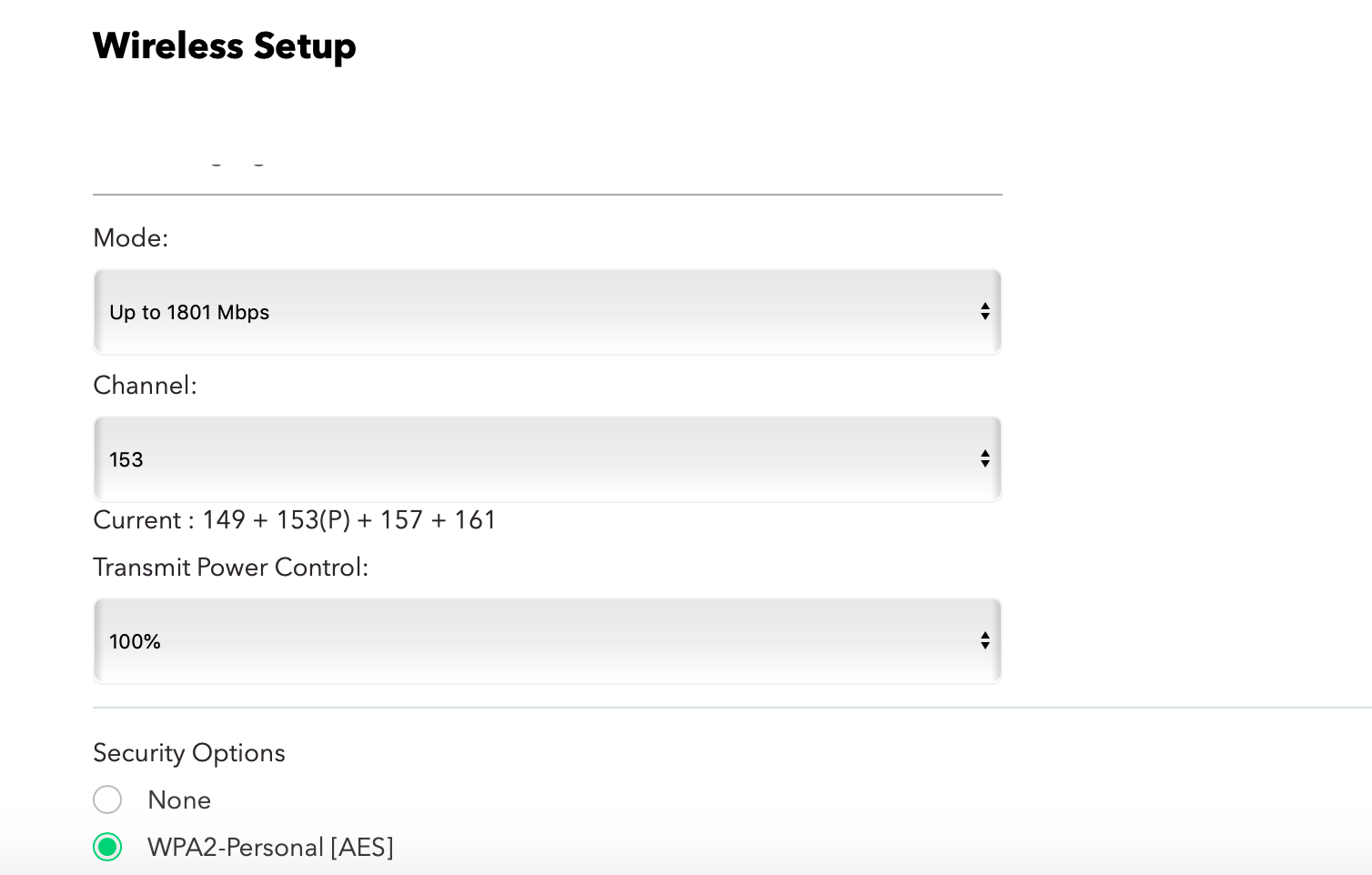

Here is some data - is this what you were looking for.
It is not letting me attach screenshots. I may have to do 1 at a time
TY again.
PS. Still only gettin 150MBS on a 1.2GB provision
