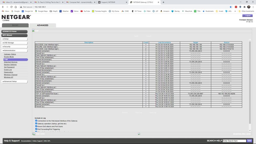

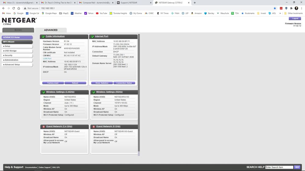

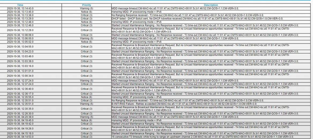

    do you have a screen snip of the cable connections page and logs? Those help check the signal back to comcast. they're great at saying "its not our lines" as a first response even if it is.
    Do wired and wireless devices drop?
    • dune21's avatar
      dune21
      I only have wireless.  Here are some snips that I took.  Do these help identify the problem?
