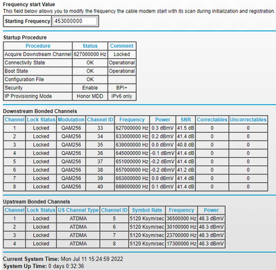

- andersv44Jul 11, 2022Aspirant
Connections Status page:
Same Coax as has been for 2 years, no splitter. Xfinity did run their tests and diagnostics from their end and found no issue.
I want to add that when I logged into the router's management page to get that screenshot - at that moment - all devices lost internet. The wifi networks SSIDs disappeared. All came back on about 2-3 minutes later. This also occurred several times the last few days while i was troubleshooting and doing the factory reset. Connect http to interface - internet drops. Not every time, but always at that instant of logging in. I don't think it's coincidence.
Thanks for the help.
- FURRYe38Jul 11, 2022Guru - Experienced User
Is there a section that gives channels being used and signal and power levels by chance?
Similar to what you see here? https://community.netgear.com/t5/Cable-Modems-Routers/CM1200-Intermittent-connection-issues-with-WOW-cable/m-p/2239274/highlight/true#M38832
Please don't post pictures with WAN IP address, MAC address or product serial numbers in public forums for security reasons.
