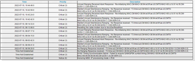

You got lots of Criticals. Something the ISP needs to look into.
https://highspeed.tips/docsis-events/
I would ask them to dis-associate the modem then re-associate the modem. Ensuring that the right config file for this modem IS being sent and applied by the ISP.
Power OFF the modem for a full minute then back ON.
Try channel 6. Channel 2 is a sub system channel, not a primary. 40 to 48 or 149 to 161 channel on 5Ghz

Ok I spoke to Xfinity and we did a factory reset while on the phone. They said from their end the router is not showing a factory reset, and the "boot file is not cleared". The tech mentioned it should be in Wallguard mode to accept re-provisioning. It isn't, so it can't be provisioned.
- FURRYe38Jul 11, 2022Guru - Experienced User
Did you press the reset button for 15 seconds or use the ERASE function on the modems web page under Advanced/Admin/Back up. I recommend using the ERASE function if you have access still to the modems web page. You might try this with the modem disconnected from the ISP coax cable.

Actually I used the "Factory Reset" button in the Administration page..Gateway Status.. Cable Information. I will try the Erase option in Backup Settings as soon as I get a chance.

SUCCESS!
I performed the factory reset with the ERASE button on the Backup Settings page - with the coax disconnected. After reboot I reconnected the coax and power cycled the router. Interface came up finally without the activation message and right now everything looks good.
Thank you so much for your assistance!
- FURRYe38Jul 12, 2022Guru - Experienced User
Glad you got it working. Be sure to save off a back up configuration to file for safe keeping. Saves time if a reset is needed.
