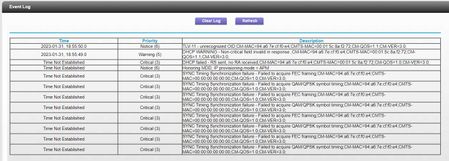

since buying this modem new it always loses connection to the internet during large downloads. its finally bothering me enough to reach out. ISP: Optimum event log.
plemans
Feb 01, 2023Guru - Experienced User
Sadly thats just the standard bootup log. It clears on reboot for most devices.
