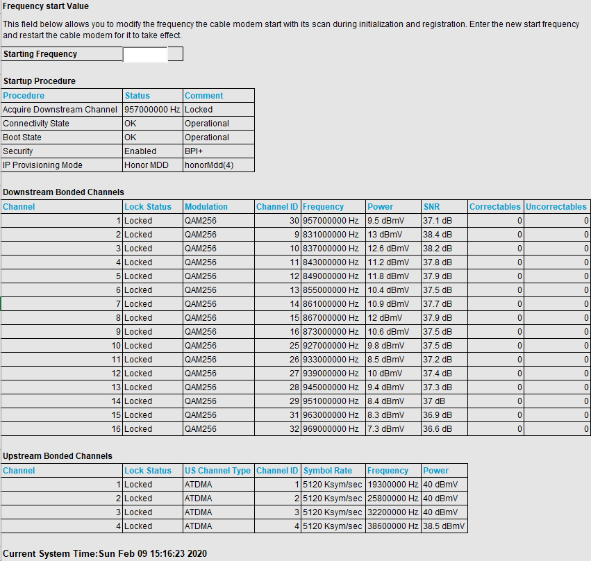

plemans , I need to apologize. I missed the other message you sent and hadn't gone directly to the line yet.
Our setup was being split outside of our home, so I didn't go straight to where it comes into the home. I did remove the splitter and tap that were in the box so that the line would only go to the room where my modem is at.
I haven't been resetting my modem, so the "correctables" and "uncorrectables" were just accumulating. Here is the data right after I got everything back up after removing my splitters. We don't actually use TV so they won't be necessary anyway.
It looks like between the channels individually they are in the range you specified now, if I'm reading it right... but I can't be sure.
