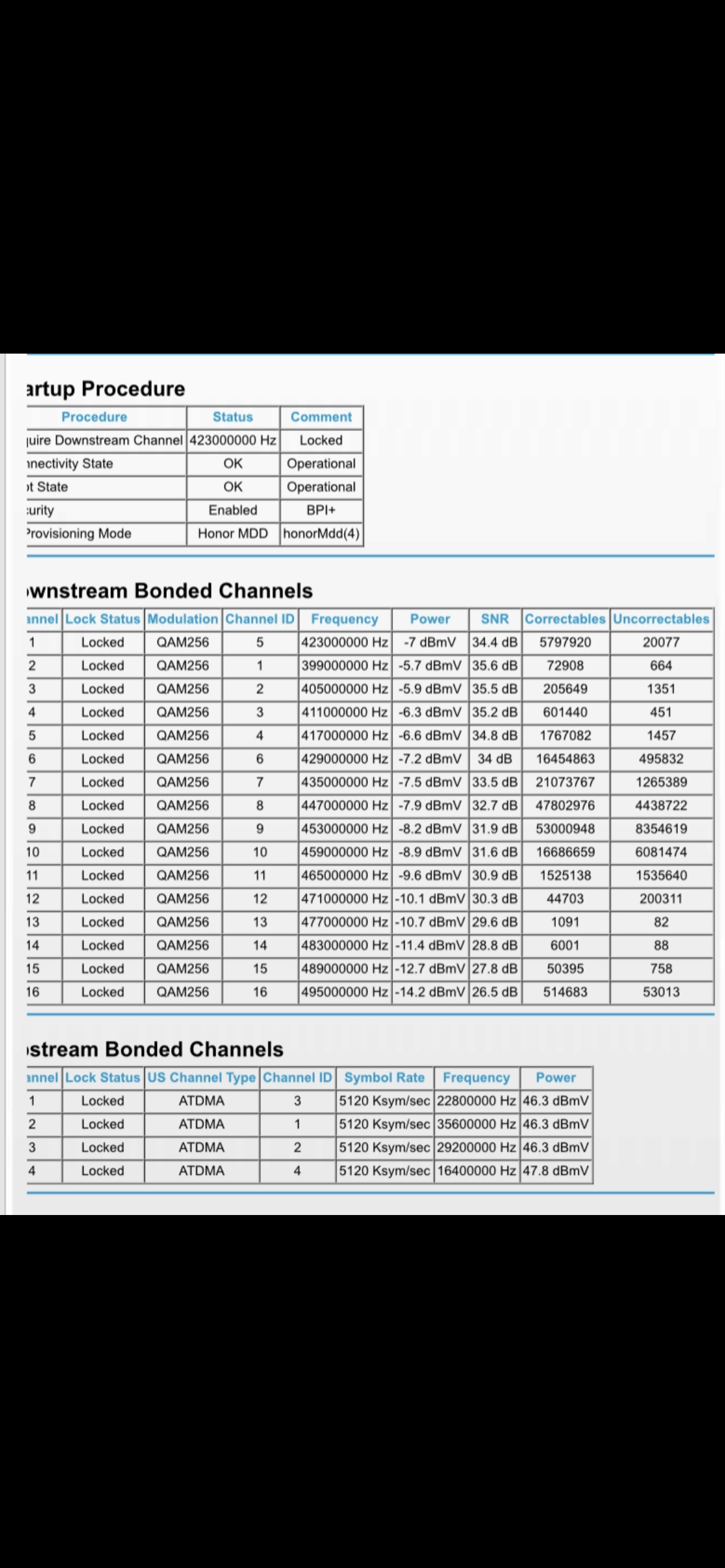

Hello, I know nothing about internet but mine keeps on going in & out and is very very slow. I recently moved & I used the same netgear device & I had no problems there. Now at my new apartment, the WiFi has been trash. I have internet with Xfinity & they came out and said they fixed something.. but it’s still so bad. I am supposed to have 100 speed & I am only registering 3 on the speed tests. Here’s a pic of that helps. Do I need to get Xfinity to come out again??

    yes you do. you have a ton of errors in your line.
    Start with removing any amplifiers, signal attenuators, or splitters from the coax.
    From there check the line for kinks, damage, moisture in the line.
    Check the connectors for improperly made ends, foil touching the copper coax line, bad/old/cheap connectors, or corroded connections. Replace them if you do.
    If you can, simply connect the modem right where the coax comes into the home. This prevents wiring in the home from being the issue. And some ISP’s charge if the wiring issue is in the home. So this helps prevent this.
