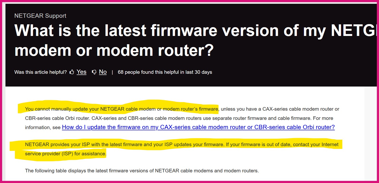

- KitsapFeb 12, 2023Master
SonnyJr wrote:I noticed version V3.01.14 is available for download. Frequently, I am losing connection. I contacted my ISP and they suggested that it has to do with my modem.
Thank you
As an end user, you do not have the option to download or update firmware for your C6300.
See attached.
Your ISP wants you to rent their modem so to increase their revenue stream.
