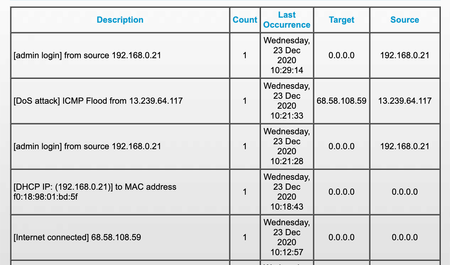

The cable connections page just takes the info from that moment in time you load the screen. Pull that cable connections page when the speeds drop.
Also, the event logs show us a longer period of time. Such as dynamic power violations (power goes in/out of spec) t3/t4 errors. which is why we'd like those :)
- plemansDec 23, 2020Guru - Experienced User
the event log helps more as that looks at the modem side.
From your cable connections page, your signal is a bit hot coming in(to high of power).
If you have just a dual splitter, put it back in line. it drops signal levels a bit coming in. and your modem can up its power for the power upstream without causing issues.

plemans wrote:the event log helps more as that looks at the modem side.
