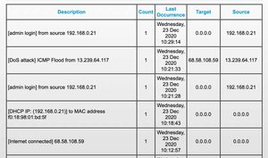

C6300 slow internet (xfinity internet)
Hey everyone, I've been having off and on slow internet for about a week now. Here some notes on what I've done so far: -There was a splitter from where the cable wire came out of the wall to...

restored123

Okay, i'll be sure to pull the cable connections when the speed drops and post it.
Here is the event logs. Sorry didn't realize this was what you wanted originally:
