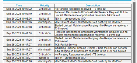

Let me know if this is what you were referring to. I am so tired of power cycling it two times a day because the wifi just stops working.

Yes. How about the Events log please.

Also you have a tone of correctables and un-correctables and should be zero.
Have the ISP check the signal and line quality UP to the modem. Be sure the ISP provisions the modem correctly.
