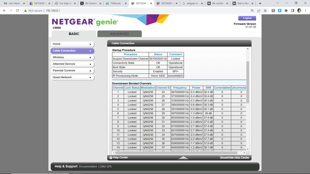

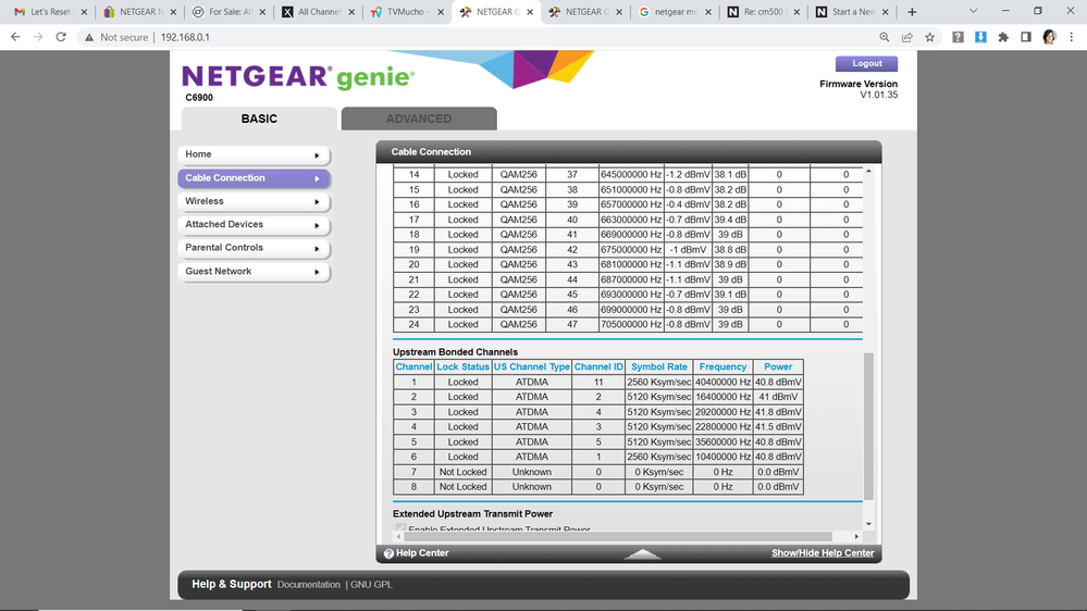

C6900 periodic poor download/upload speeds
I have been having issues with download/upload speeds for a number of weeks.  When I do the speed test, the numbers are all over the place.  I had a Comcast tech out week before last.  I was told he is a senior tech and works mostly on the business side.  So, I felt comfortable that he knows what he's doing.  He checked things at the box where all of the homes in my neighborhood are hooked up.  He checked the connection that comes out of the ground and then cable that comes into my home all the way to the modem.  He determined that the modem is failing and that he'd seen a fair number of "these" that failed right out of the box.  So, I bought a new modem/router, but have not hooked it up.  I'd like to get an opinion from the smart folks before I go through the hassle of installing a new modem and reconfiguring my network and all of the attached devices.

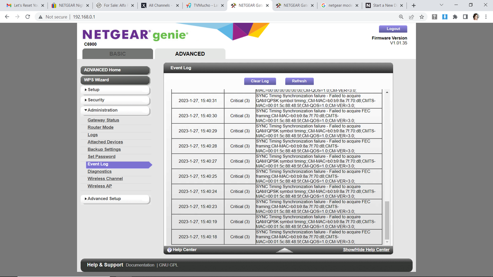

The log file indicates a timing synchronization failure at the modem.  There is also mention of another MAC address (CMTS).  I cannot find this MAC address on my network, anywhere.
If I've left something out that would help, please let me know.  I know nothing about these gizmos.  Thank you.
