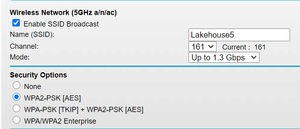

C7000-100NAS not Performing At Speed
I needed to upgrade Spectrum service to their Ultra, 400mbps. After doing so, I could not get that with either my 5mHz nor through a 6e patch cord onto either a Dell Laptop nor my Pixel phone, I had...

Hardwired into the router with a cat7 patch cable my Dell Laptop gets around 50 mbps down and 20 up. Using my Pixel phone with data turned off, speedtest.net gives the same two values with some small variations.
