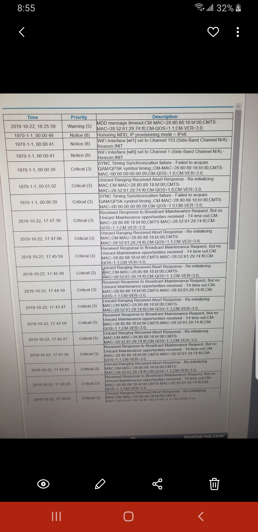

I have a C7000v2 I purchased a few months ago from Best Buy as the box advertised that its compatible with Xfinity internet.  Being tired of renting a cable modem I made the purchase.  It worked great a month or so then started dropping the internet.  About 6 months prior to this I did have Comcast out as they were emailing me my signal was weak (or something to that effect).  The tech replaced the box in my garage and checked all my connections.  Ive had great service for 11 years now with 500mb inetrnet speeds.  Ive had no connectivity issues until I bought the Nighthawk.  Now, I have to factory reset the cable modem weekly to keep a consistent connection with the internet.  I came home last night and took pictures of the error log before and after reset.  My internet is working ok today but the upstreal light is now amber.  Given time the internet will start to drop out again, as evidenced by the TVs and phones etc freezing up when streaming videos etc etc.  What can I do to prevent this?  I never had this problem with the rented cable/modem from Xfinity.  Thank you.

    Be sure there are no cable coax line splitters in between the modem and ISP service box.
    Have the ISP check the signal and line quality UP to the modem.
    Be sure your using good quality RG6 coax cabling up to the modem.
    What channels are you using? Auto? Try setting manual channel 1, 6 or 11 on 2.4Ghz and any unused channel on 5Ghz.
    Any Wifi Neighbors near by? If so, how many?

      This was an xfinity issue.  Havent factory reset in a month.
