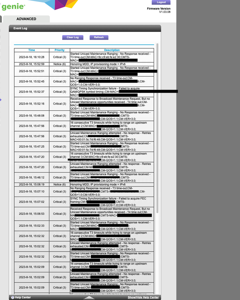

I can include the event log, but i believe it mentions MAC so I need to blank those out right?

You have a ton of correctables and un-correctables that should be zeros.
Please edit out the MAC ADDRESSES before posting the event log if you see any.

These are the event logs:- FURRYe38Aug 18, 2023Guru - Experienced User
Any Criticals, Errors or Warnings seen in the event logs needs to be reviewed and resolved by the ISP. Indicates a signal issue on the ISP line up to the modem. Especially T3 Timeouts.
Have the ISP check the signal and line quality UP to the modem. Be sure the ISP provisions the modem correctly.
The power needs to come down for sure.
Be sure there are no coax cable line splitters in the between the modem and ISP service box.
Be sure your using good quality RG6 coax cable up to the modem.
Start with removing any amplifiers, signal attenuators, or splitters from the coax.
From there check the line for kinks, damage, moisture in the line.
Check the connectors for improperly made ends, foil touching the copper coax line, loose connections, bad/old/cheap connectors, or corroded connections. Replace them if you do.
Be sure to power OFF the modem for 1 minute then back ON.
https://community.netgear.com/t5/Cable-Modems-Routers/General-info-and-Troubleshooting-for-Cable-Modems/m-p/1530376#M12853
https://kb.netgear.com/24311/Power-level-guidelines-for-a-NETGEAR-cable-modem-router
https://www.duckware.com/tech/solving-intermittent-cable-modem-issues.html
https://highspeed.tips/docsis-events/- Bryan_QAug 21, 2023Aspirant

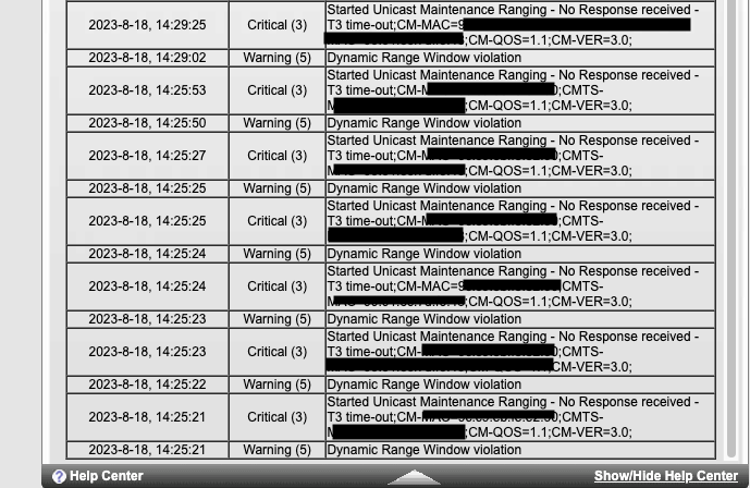

So far no issues in the past 24 hours and here is the cable logs as well. Power is higher than normal, but better than the previous picture as it also had +15 and -15, which the guy said he never seen before as his diagnostic tool wasn't triggering the no grounding issue.
