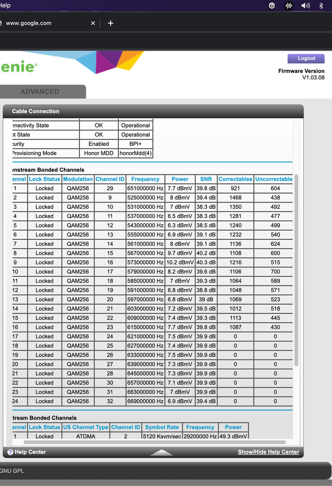

So far no issues in the past 24 hours and here is the cable logs as well. Power is higher than normal, but better than the previous picture as it also had +15 and -15, which the guy said he never seen before as his diagnostic tool wasn't triggering the no grounding issue.

Power is WAY TOO HIGH:
https://kb.netgear.com/24311/Power-level-guidelines-for-a-NETGEAR-cable-modem-router
Going to burn out the modem eventually.Ask about installing a -6dbm attenuator on the line behind the modem.

I will ask to see if they can do that. I attached the most recent cable connection log from like 10 minutes ago. The issue just happened again after going a week strong without issues 😐.
