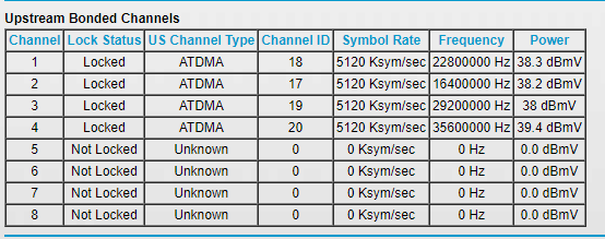

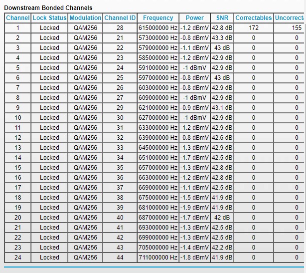

Ok power levels look ok.
Some Correctables and Un-correctables on the one channel. Should look like the rest of the channels though.

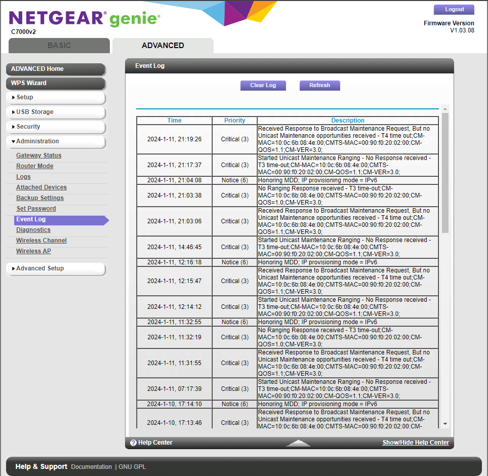

You have lots of Criticals. Any Criticals, Errors or Warnings seen in the event logs needs to be reviewed and resolved by the ISP. Indicates a signal issue on the ISP line up to the modem.
Have the ISP check the signal and line quality UP to the modem. Be sure the ISP provisions the modem correctly.
