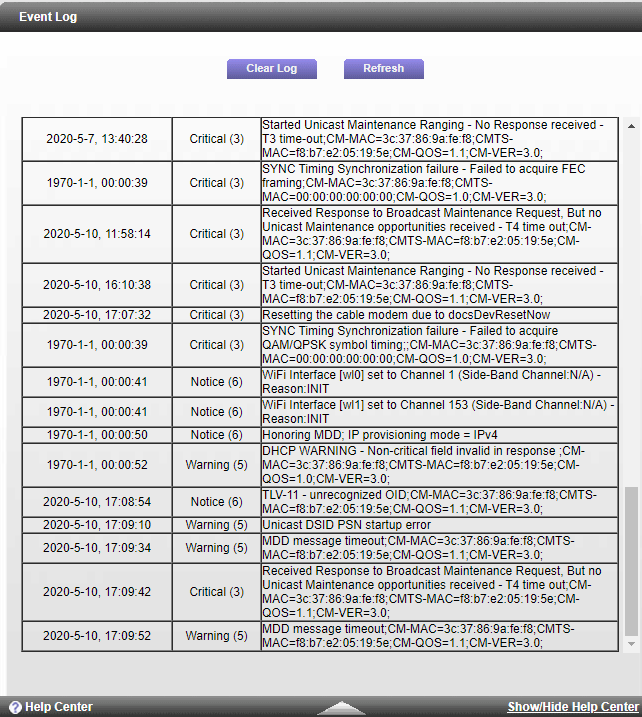

I could not figure how to paste them into this reply, but the download channel info is attached. The download light is blinking green which I think means it is searching for a channel. Upload lilght is solid green. Internet is solid green. 2.4 and 5 are blinking green but we have devices using both, and wifi on/off button is blinking green. Cox said there are no packet drops and it must be me. I am on a Windows 10 desktop. Sometimes the impact seems to be worse than other times, but it seems to effect both wired and wireless items at its worst.
- CJinVAMay 11, 2020Guide
The log is attached.
