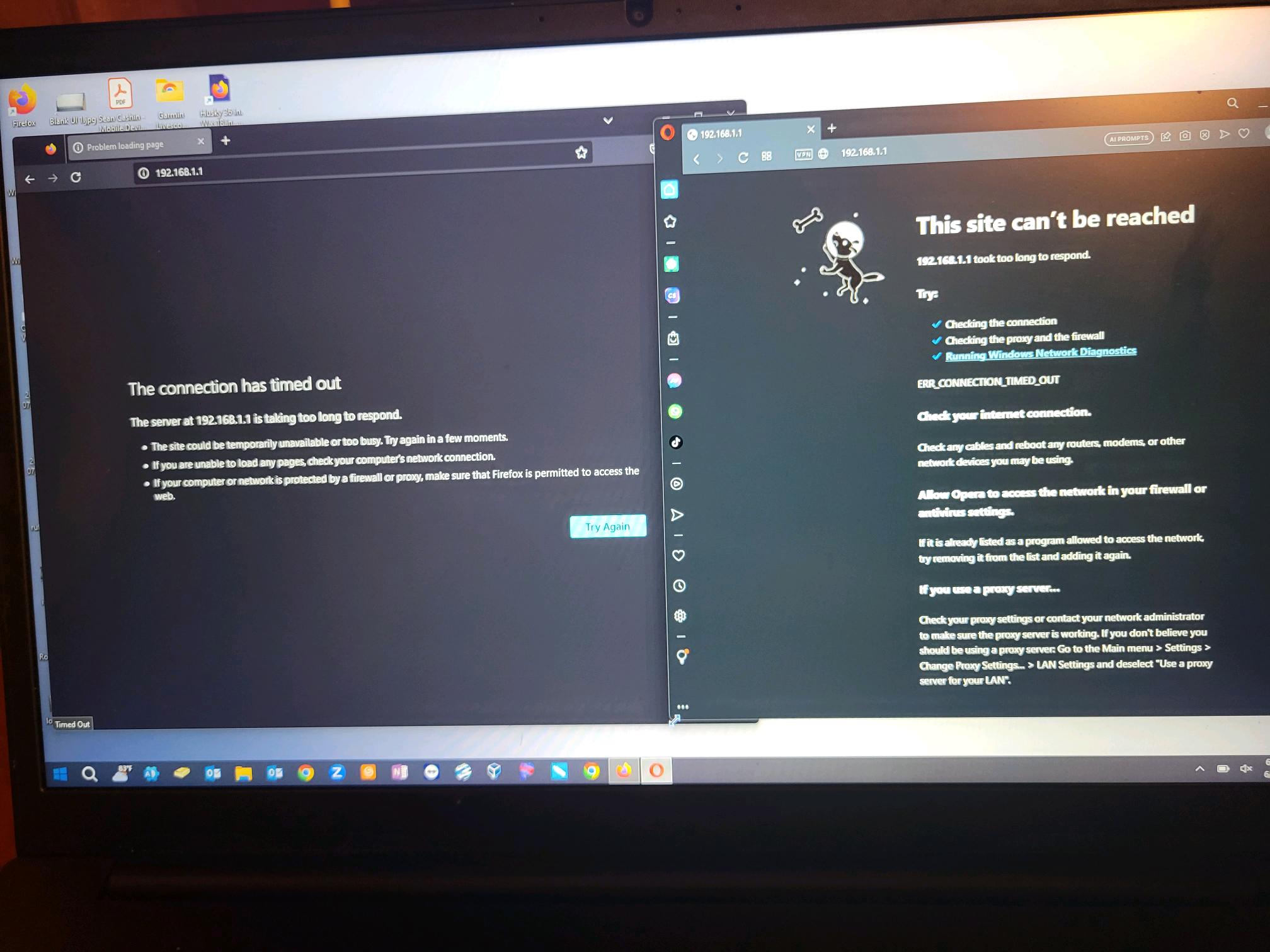

I just disconnected the coaxial cable from the router followed by a reset. With RJ45 connected to a laptop and freshly installed Firefox and Opera - neither one of the browser can reach 192.168.1.1 shown in screen shot attached
I couldn't ping 192.168.1.1 but if I were to ping 192.168.0.1; I get a response back.
Result below:

- FURRYe38Jun 02, 2023Guru - Experienced User
Last thing to try is a 30-30-30 reset.
If this fails to bring access the modems web page, I think the modem needs to be replaced. - NoyS_609Jun 03, 2023Aspirant
