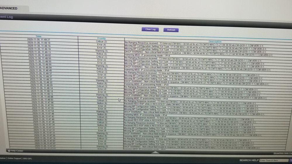

The activity log shows these repeating messages:
Honoring MDD; IP provisioning mode = IPv4
DHCP WARNING - Non-critical field invalid in response
Missing BP Configuration Setting TLV Type
No Ranging Response received - T3 time-out

    do you have a screen snip of the cable connections page and the event logs? That lets us look at the connection back to the isp.

      The modem owner asked to pay for GearHead support.  They conducted a few more tests and have issued an RMA for this modem.  This may no longer be interesting to anyone.  However I believe I did capture the 2 pictures as you described in case anyone else is having this problem.
