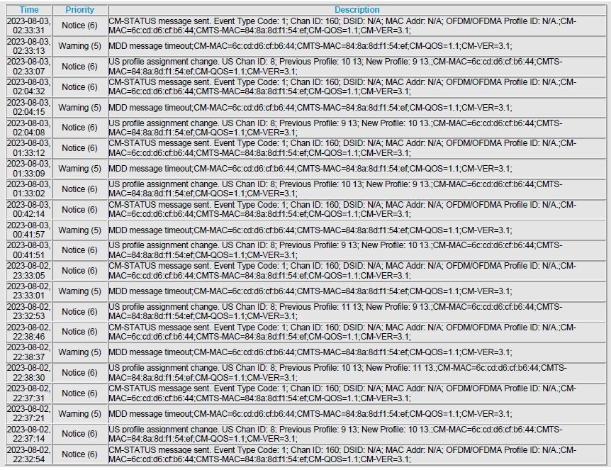

- bmaravanAug 03, 2023Aspirant
I finally managed to login to the admin panel, tried COAX and clearing Cache and everything, wouldn't work the other days, today it seems to work fine and I am connected wirelessly.

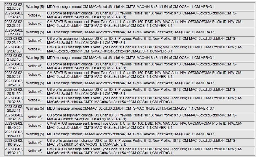

Show/Hide - FURRYe38Aug 03, 2023Guru - Experienced User
Please post a copy and paste of the modems connection status page.
https://kb.netgear.com/30007/How-do-I-obtain-the-cable-connection-information-from-a-NETGEAR-cable-modem-modem-router - bmaravanAug 03, 2023Aspirant
Let's try that with a Link, here you go Connection Page
Power is ok on some channels however you have a few channels that are on the high side opposite from where the other channels are. All channels should be around 3db in power across all channels:
https://kb.netgear.com/24311/Power-level-guidelines-for-a-NETGEAR-cable-modem-router
I see some correctable that should be zeros but are not too bad.
Any Criticals, Errors or Warnings seen in the event logs needs to be reviewed and resolved by the ISP. Indicates a signal issue on the ISP line up to the modem.
Have the ISP check the signal and line quality UP to the modem. Be sure the ISP provisions the modem correctly. Have the channel power checked for power levels across all channels.
Be sure there are no coax cable line splitters in the between the modem and ISP service box.
Be sure your using good quality RG6 coax cable up to the modem.
Start with removing any amplifiers, signal attenuators, or splitters from the coax.
From there check the line for kinks, damage, moisture in the line.
Check the connectors for improperly made ends, foil touching the copper coax line, loose connections, bad/old/cheap connectors, or corroded connections. Replace them if you do.
Be sure to power OFF the modem for 1 minute then back ON.
https://community.netgear.com/t5/Cable-Modems-Routers/General-info-and-Troubleshooting-for-Cable-Modems/m-p/1530376#M12853
https://www.duckware.com/tech/solving-intermittent-cable-modem-issues.html - bmaravanAug 05, 2023Aspirant
