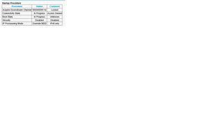

Cable Modem CM600 stuck in IPv6 mode - how do I get it reset?
I have had TWC internet as my ISP for several years and have been using my own Cable Modem, CM600 with no issues. I recently switched to WOW internet as my ISP. The installer came and upon attem...

Sounds like a firmware bug. Here is a post from a WoW employee further describing details of your issue - looks like its by design that this setting can't be reset:
https://www.dslreports.com/forum/r30887250-
I recall reading about a similar bug on Arris SB6121:
Have any Comcast friends who will let you activate this modem on their account? It would then get a firmware upgrade since Comcast uses v6 provisioning. Its possible this is fixed in a later firmware and you could then use it on WoW. This table indicates Comcast uses a later firmware:
What did Netgear support say?
