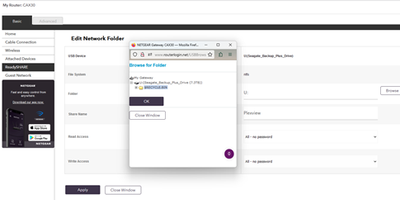

CAX30 AX2700 ReadyShare shows connected drive but the folder is empty
Hi, any help would be appreciated. I have CAX30 AX2700 modem router with USB connected external 8GB drive. I use the drive for playing videos only through Plex Media. The system is Windows 11 Home. ...

KO45BIN
Feb 22, 2023Guide
