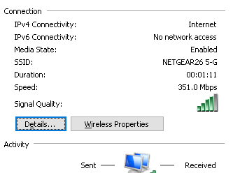

My CAX30 has low and unstable internet. My 5GHz which is supposed to go up to 800 mbps caps at 351 and fluctuates from 120-351. My 2.4GHz fluctuates from 81 to 220 mbps on my laptop. On startup, th...

There are 9 wireless devices connected to the router. Most of them are my families and are connected to the 2.4GHz, as per my knowledge, there are 2 laptops and 1 phone connected to the 5GHz one.
Are your wireless devices supporting of AX modes?
I am not sure. The laptop in question is a Dell Latitude E7240, so its on the older side. The other laptop, which is a Mac, that is connected also experiences slow speeds at times, so I don't think its a problem with my laptop itself.
On ookla, I'm getting about 150 mbps.
- Shyam723Jul 18, 2022Aspirant
Forgot to mention, with wired its about 600 mbps, but wired connection isn't viable for me.
- FURRYe38Jul 18, 2022Guru - Experienced User
You'll need to check with the wireless devices Mfr to see what connection rates and wireless modes that are supported on those devices.
Most AC supporting devices top out at around 300Mpbs on 5Ghz AC.
