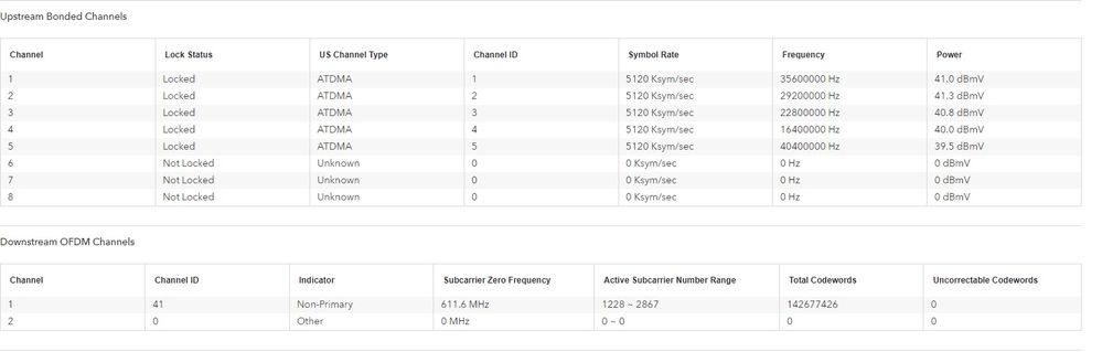

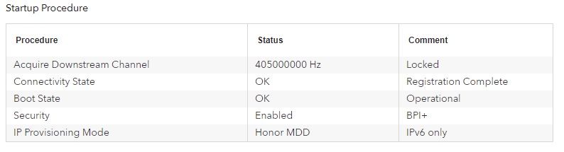

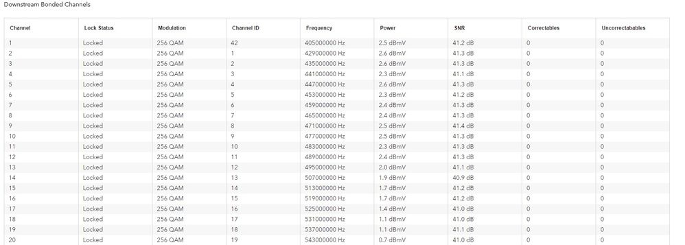

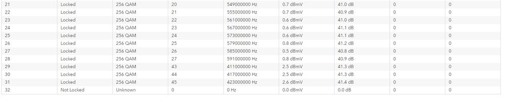

- plemansAug 26, 2021Guru - Experienced User
Do you have a screen snip of the cable connections page and the event logs?
- JohnnieWalker22Aug 26, 2021Guide
- plemansAug 27, 2021Guru - Experienced User
photos have to be approved by a moderator and it can take a while. Or you can click on "choose file" and attach them individually
