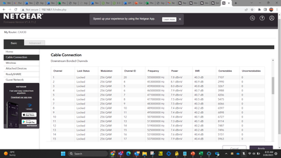

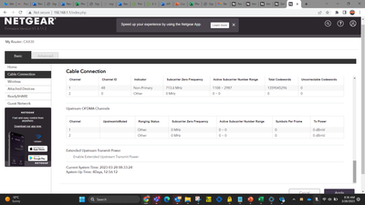

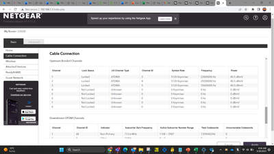

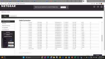

Cable connection:

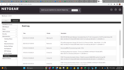

Event log :

- FURRYe38Mar 28, 2023Guru - Experienced User
Power levels on some channels are too high:
https://kb.netgear.com/24311/Power-level-guidelines-for-a-NETGEAR-cable-modem-router
Might try adding a coax line splitter or an inline attenuator to help lower the power.
You have too many Correctables that should be zeros.
Be sure your using good quality RG6 coax cable up to the modem.
From there check the line for kinks, damage, moisture in the line.
Check the connectors for improperly made ends, foil touching the copper coax line, loose connections, bad/old/cheap connectors, or corroded connections. Replace them if you do.
Be sure to power OFF the modem for 1 minute then back ON.
https://community.netgear.com/t5/Cable-Modems-Routers/General-info-and-Troubleshooting-for-Cable-Modems/m-p/1530376#M12853You have Criticals and Warnings that the ISP needs to review and resolve.
Have the ISP check the signal and line quality UP to the modem. Be sure the ISP provisions the modem correctly.
Might ask them to help you reduce the power levels on the line.
