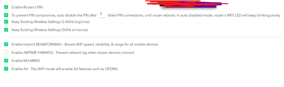

Also what are the configuration settings under Advanced/Advanced Settings/Advanced Wireless?
Wireless Advanced Settings (2.4GHz b/g/n/ax)
Fragmentation Length (256-2346):
2346
CTS/RTS Threshold (1-2347):
2347
Preamble ModeLong Preamble
The wireless signal is scheduled to turn off during the following time period:
Period Start End Recurrence Pattern
Add a new period Edit Delete
Wireless Advanced Settings (5GHz a/n/ac/ax)
2346
2347
WPS Settings
Router's PIN:Has a factory reset and setup from scratch been performed since FW was updated? Everything else works on the device. Not factory resetting when i can just fix NetGears issue by changing to 2.4Ghz when i need to upload, that way I don't have to mess with anything else on my network. I have too many static IP's and configs for specific devices on my network to go through that process unless the router burns to the ground and forces me to.
