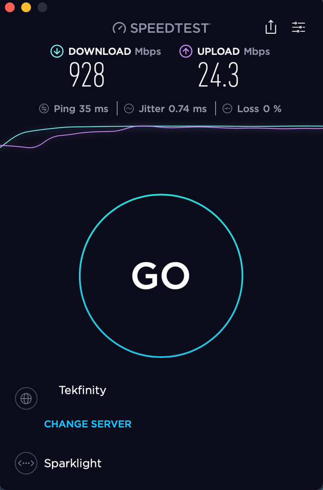

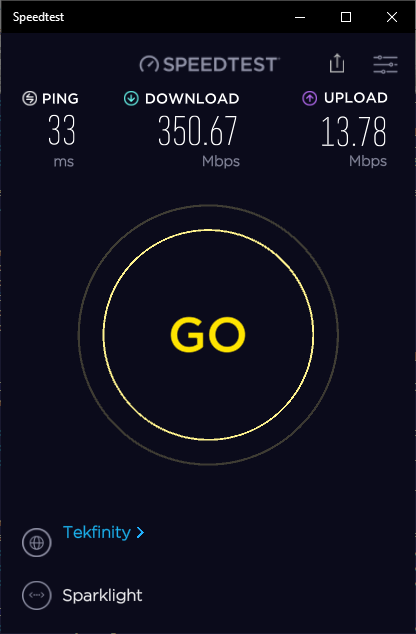

4. Wireless on two different wifi client adapters is not to spec on the upload. Should be at 50Mbps. I'm not seeing that:

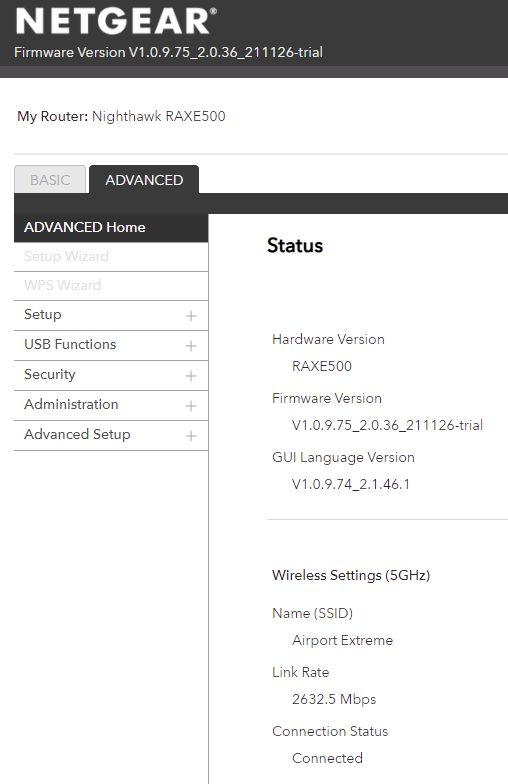

Connection rate on my ASUS in wifi bridge mode is good:
The ASUS has testing out on other routers and gets to spec speeds on the up so I know it's not the ASUS.
I connected a D-Link DWA-192 and got around 30Mbps on the uplink, still not 50Mbs.

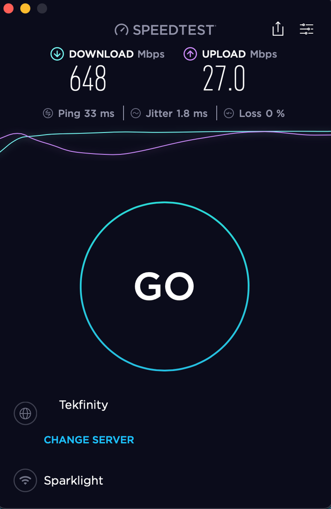

Ok so testing my RAXE500 wireless bridge mode on 5Ghz with the CAX80 both far and close distances, uplink speed tests are bad and not to spec:
RAXE500: 20ft distance
RAXE500 at 8 feet distance from the CAX80:

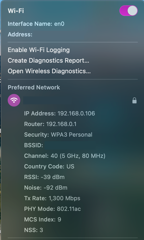

A Macbook Pro 2018 native wifi:
